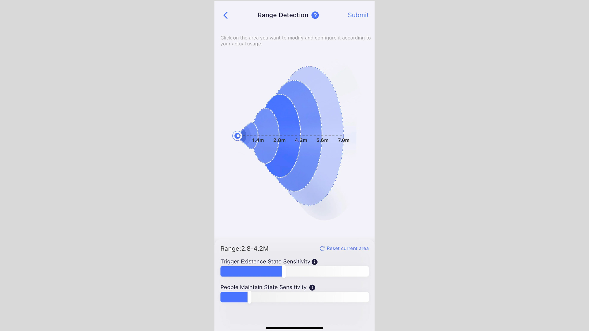

Advanced settings are controlled via the Lafaer app. Once the sensor is paired with your thread network, the app will advise you to hold the button for three seconds which will allow it to pair with the Lafaer app as well. You can adjust various settings with range detection, and sensitivity at each range gate (see pictures below). There are various other options for doing an AI calibration based on where it is set up, changing the detection reset interval, performance vs battery save mode etc.

Lafaer claims the LWR-01 can do motion detection out to 7 meters and will maintain presence detection out to 3.5 meters. It breaks its detection range gates out in 1.4 meter increments that can you individually change detect and maintain sensitivities for (see below picture).
r/homeassistant - Lafaer LWR-01 Wireless Presence Sensor More Updates and Initial Review - Detection Range
From what I tested, the range gates are fairly accurate. When I disabled the further out range gates one by one, it would not detect me until I came close to the marker I had on the floor for the next range gate.
It was consistently triggering motion detections out to 7 meters but would in fact not maintain presence at that distance. My testing methodology for this was to walk into the scene to trigger motion detection and then I sat in a portable chair remaining still.
From my testing however, the sensor was consistently maintaining presence on me out to ~4 meters, so a little better than Lafaer claims.

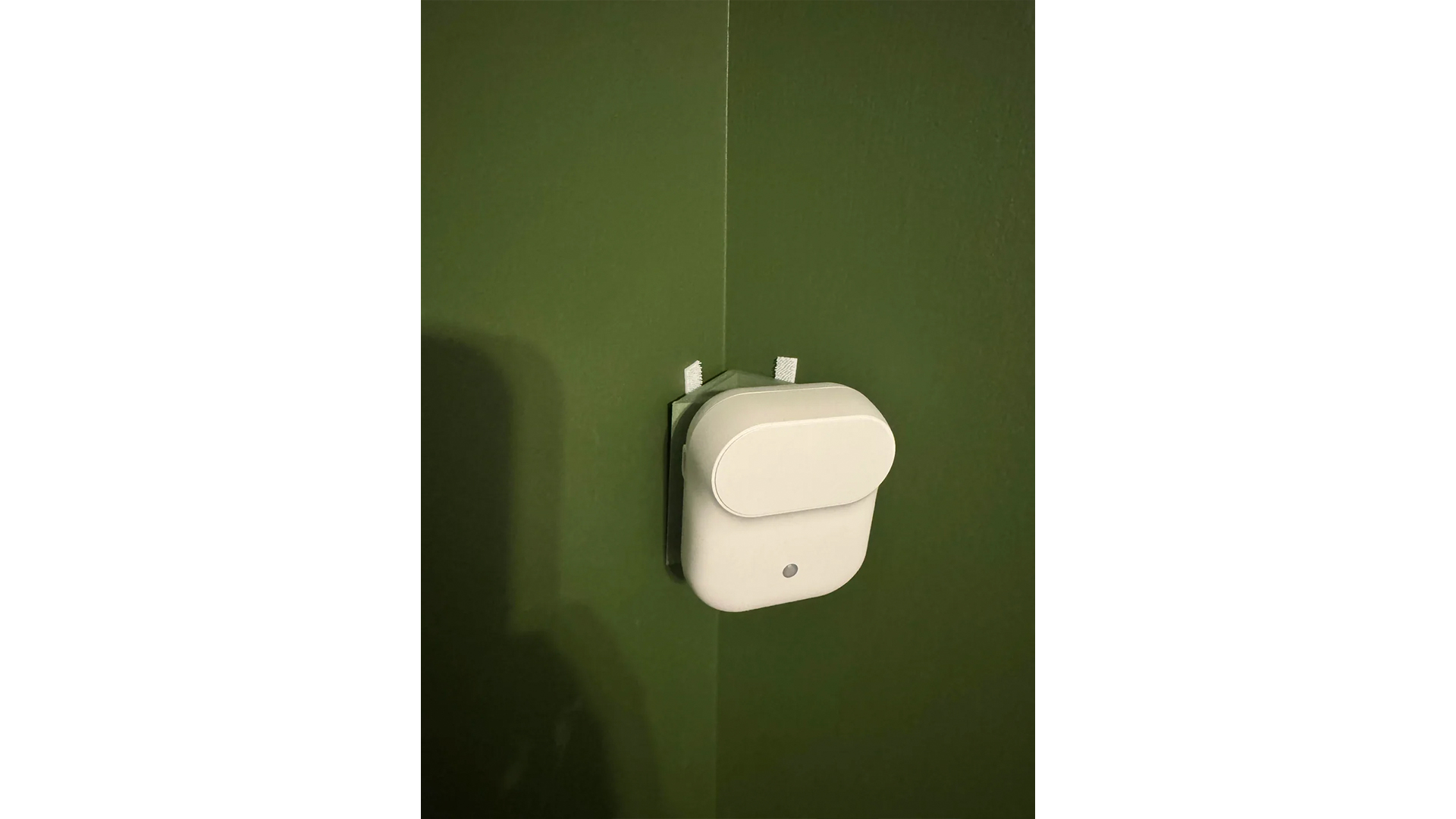

I was having trouble yesterday with my corner mounted sensor detecting my ceiling fan. It had this issue both ½ and 2/3 of the way up the wall.
r/homeassistant - Lafaer LWR-01 Wireless Presence Sensor More Updates and Initial Review - Wall Mount

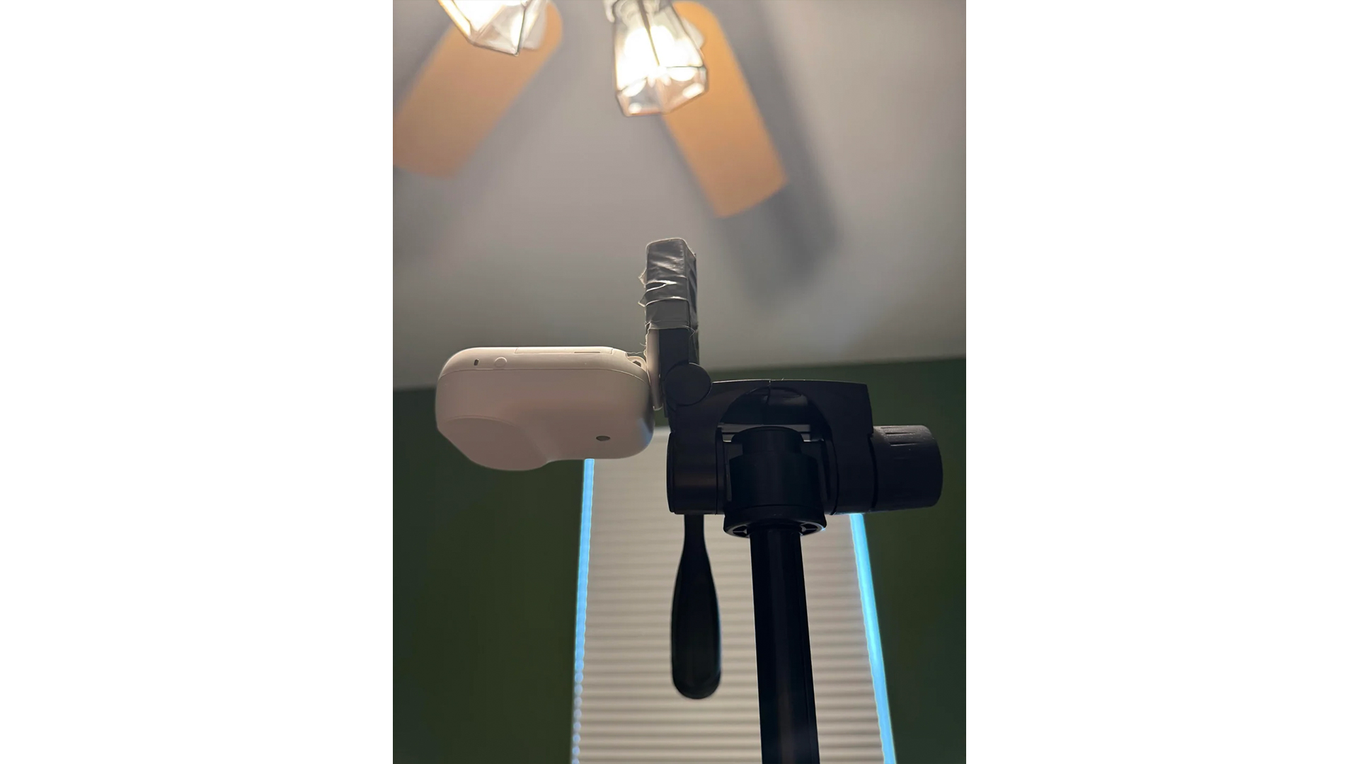

I adjusted various detect and maintain settings hoping that it was just the air movement it was detecting and not the blades. To confirm, I set up my second sensor so it was pointing down directly underneath the fan, where it couldn’t see the blades.
r/homeassistant - Lafaer LWR-01 Wireless Presence Sensor More Updates and Initial Review - Adjustment

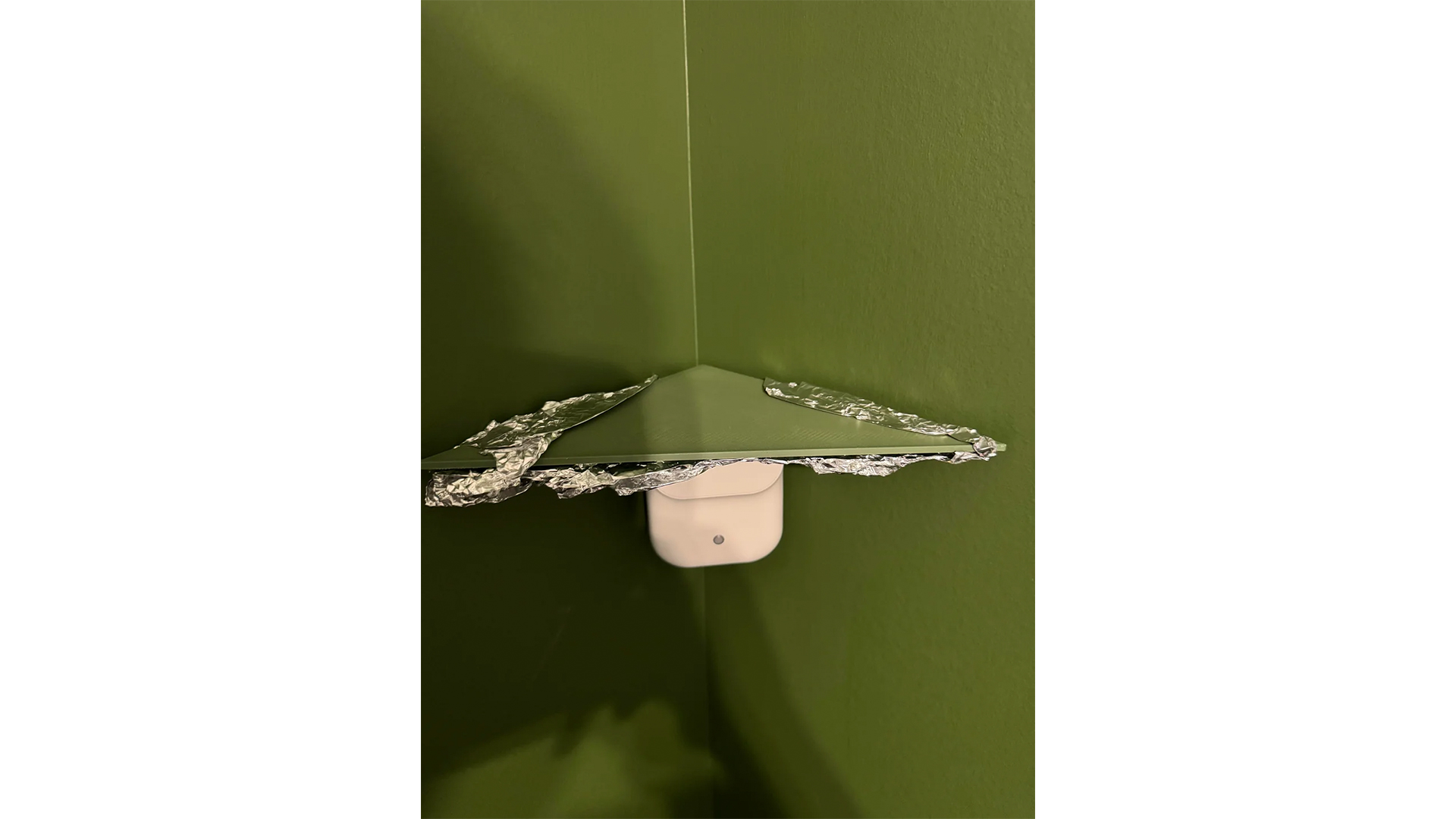

This sensor also triggers with default settings, but lowering the detect and maintain sensitivity did in fact cause this sensor not to trip. My fix for my other sensor was to 3d print a cover (the final version will only have foil on the bottom) in order to block the beams that we’re seeing the fan.
