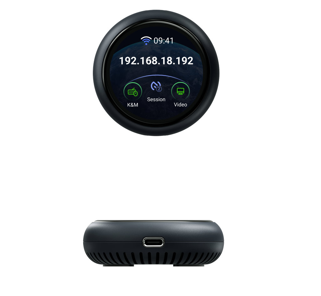

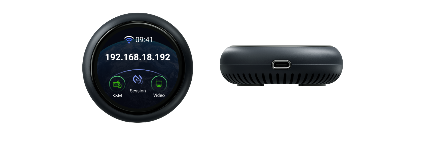

Technical Specifications
Interface 1 x USB Type-C (power passthrough)
1 x USB Type-C Cable (support DP Alt Mode)
Operating System Buildroot
CPU ARM Cortex, quad-core
Memory / Storage LPDDR4 512 MB / NAND 512 MB
Display Screen 1.8 in, touchscreen
Wi-Fi Speed 5 GHz: 286 Mbps
2.4 GHz: 286 Mbps
Antennas 1 x internal Wi-Fi antenna
Resolution 2K QHD@60FPS
Power Input Type-C PD, 5V/3A
Dimension
